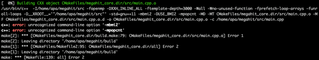

MEGAHIT is an NGS assembler tool available as a binary for x86_64. A customer wanted to run MEGAHIT on Arm64 as part of an architecture transition. But the compilation failed on Arm64 in the first file:
The developer wanted to know what needed to be changed to make MEGAHIT compile correctly on Arm64.

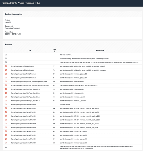

In this case, Ampere Porting Advisor (APA) can play a key role. After scanning the source repository of the MEGAHIT project with APA, we get a list of issues that need to be checked before rebuilding MEGAHIT on Arm64:
Let’s investigate each error type in the list and correct them for Arm64 if necessary.

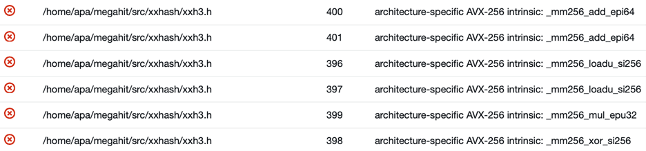

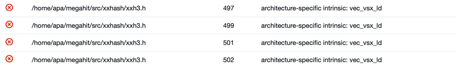

Architecture specific SIMD intrinsic
The architecture specific instructions error will be triggered once APA detected x86_64 SIMD instructions like AVX256 or AVX512 being used in the code. These SIMD instructions are wrapped by precompiler conditional flags and will usually not cause any functionality issue on Arm64. If there were no SIMD implementation of the algorithm for Arm64, there could be a performance gap compared to x86_64. In this case, there is a NEON SIMD implementation for Arm64 in xxh3.h and this implementation will be cherry picked by the compiler based on the CPU architecture. No further actions need to be taken.

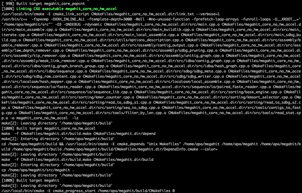

Rebuild and test
Once all these adjustments have been made, we could rebuild the project:

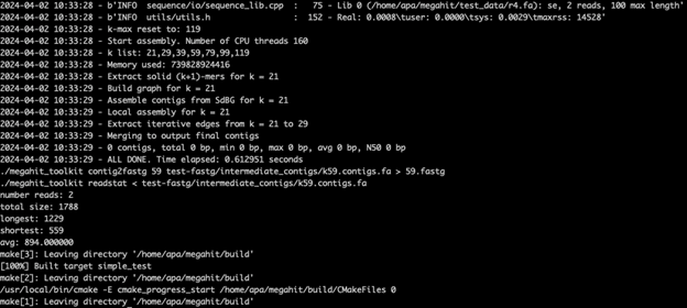

The project compiled successfully. We then checked whether it passed the project’s test suite:
After we have manually checked and fixed all the potential pitfalls reported by APA, MEGAHIT is now able to build and run on Ampere processors.
