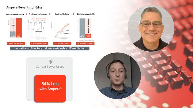

Cloud Native Advantages in Edge and Embedded Systems
First, let’s talk about predictable performance. Ampere Cloud Native Processors scale from 32 to 128 cores in a device, give more compute in any given power budget, and deliver best-in-class performance per Watt compared to x86 CPUs. The Ampere® Altra® Family of processors are designed to deliver uninterrupted, predictable performance.
Whether you have 32 or 128 cores, each core is single threaded, eliminating the noisy neighbor problem. At the edge, this translates to freedom of interference when running many different workloads on a single processor. For example, in robotics and autonomous driving there is a need to have perception pipeline, sensor fusion, path planning, and other workloads all running at the same time without impacting each other.
Scalability is another key feature of Cloud Native Processors. Cloud workloads are designed to scale out across many cores, many servers, and many racks. When you put these workloads and open-source software into a very dense compute—like the Ampere Altra processor—they’re scaled out and run alongside other workloads.
Finally, power efficiency and sustainability are core to the Ampere Cloud Native Processors. The way we've architected and developed the technology, and how we work with community to optimize entire solutions—including software—goes a long way toward a more sustainable future.

Cloud Native Benefits for the Edge:
  • More cores for any given size, weight, and power (SWaP)
In domains such as industrial controls, robotics, autonomous driving, transportation, and 5G this ability to have very high performance with low latency and very low jitter, even if multiple workloads running concurrently on the same SOC, is critical—as is the ability to scale linearly.
And with things like Kubernetes, you're managing all the cores in your pool. As you deploy your workloads to incremental cores, you get linear scaling, efficiency, sustainability, and the ability to pack more compute into your limited size, weight, and power (SWaP).
Efficiency and Performance at the Edge
Compared to x86, you can get triple the compute for the same energy budget with Ampere. Or to say it another way, you can get the same compute performance using 1/3 the energy. This is possible because of our efficient processor.
Improving efficiency without sacrificing performance is good for embedded systems where people keep adding more sensors, higher bandwidth sensors, and higher bandwidth communications to their computer while constrained by the existing space, power, and weight for the compute. For example, if you look at something like a 16 core Intel Xeon D — using just two-thirds of the power, Ampere can give you double the compute with our Q64-22— a 64 core 2.2 gigahertz part. If you look at our 128 core 2.6 gigahertz processor, you get over triple the compute for about the same power budget.
